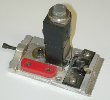

Here is my jig - aluminum, UHMW plastic, and 1/4 20 threads all round, except the large bolt down the main fence, its 1/2-13. I made this based on a local Taylor repair guys jig - except his had different machined alum verticals to change the width of cut - nice, but expensive to have done. This jig can handle any binding purf scheme, no matter what the size. I use a 1/4 downcut solid carbide bit.
The bolt out the left is the width adjust, it helps set the distance from the bit for the vertical fence. The red UHMW keeps the vertical fence square as adjustments are made. The router mounts vertically from the bottom, the bit protrudes up thru the shoe, the right most black UHMW piece. It has a contact area about half the size of a quarter, so it can handle either the 18 or 28 radii I use. I notched out the main fence (it is actually made of two pieces, you can see the join, but it really doesnt matter, the area it rides on is huge compared to most jigs) to only register on the outer parts of a side while routing. Its fairly easy to control, and I do all the ledges in climb cut while the guitar is held in a big body clamp vise - this helps keep any tear out to a minimum.
PostPosted: Mon Mar 13, 2006 12:42 am
SOme more info - the bolt head behind the vertical fence holds the fence down to the bottom plate - The plate that the fence is bolted to has a slot in it, allowing it to slide back and forth once the bolt is loose. The rear bolt sets the depth. So lets say you are setting up for binding - I set the fence shallow, route and see where I am at - then tighten the rear screw against the fence plate before loosening the hold down bolt. Every 1/4 turn of 1/4-20 is 12.5 thou, so its pretty easy to adjust say an 1/8 turn, adding 6 thou to the width of the route, tighten the hold down, route, then check it again. Within 3 or 4 adjusts, I get the width dead on, then do that route. This is the main reason I want to make another of these - to have it set permanently for a 85 thou wide binding channel. Depth is easily set by the router height of the the bit.

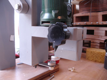

I don't use the LMI bearings ,my set up uses a parallalagram type jig and use a downward cutting spiral bit.
Hope picture comes out OK.
